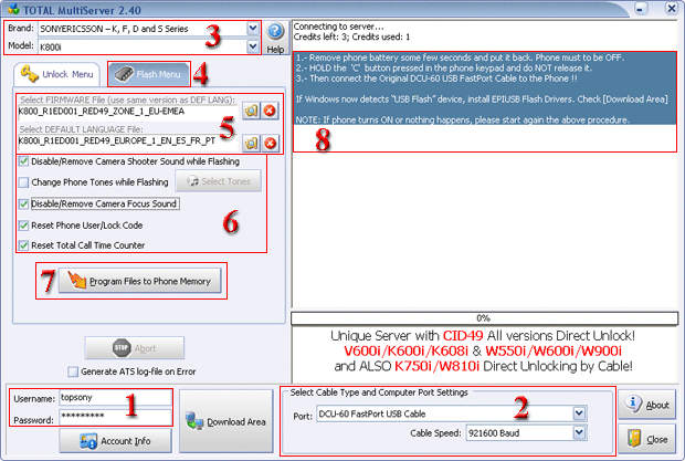

    Upgrade firmware - Debrand - Change the language
    Fill username and password.
    Select the cable type, port and velocity
    Select the brand of your phone.
    Select "Flash Menu".
    In "Select FIRMWARE File", click in and select the firmware file. In "Select DEFAULT LANGUAGE File", click in and select the language file.
    Select the advanced options you want
    Disable/Remove Camera Shooter Sound while Flashing
    Change Phone Tones while Flashing - Change the SMS sounds.
    Diisable/Remove Camera Focus Flashing - Disable the autofocus sound.
    Reset Phone User/Lock Code
    Reset Total Call Time Counter
    Click in "Program Files to Phone Memory".
    If you use DCU60 cable - With the turned off phone, quit and reinsert the batery, press and hold pressing the "C" key and connect the DCU-60 cable to the phone.
    If you use Service Cable(Total Multiserver - Cruiser - DSS - T28 cables) - With the turned off phone, quit and reinsert the batery, connect cable to phone, and in some cases you need to press the "ON" key. (used to turn on the phone)

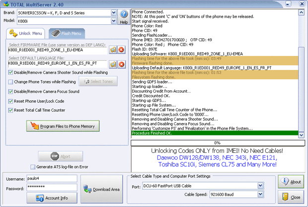

    Wait, the program will do this:
    Write the MAIN Firmware file.
    Write the language file.
    Discount the log.
    Run the advanced options selected (like remove camera sound and others...)
    Do the finalization of the phone. Don't unplug the phone until you see the message "Procedure Finishid OK". Quit the battery a few seconds befor turn on your phone.
