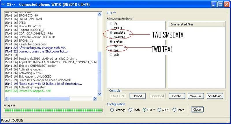

    5) Uploading files via FSX *optional*
    FSX can be used as a way of customizing your handset just like step 4. This would be done if a user had a custpack they wanted to use which wasn't in XS++ yet or adding or changing cam drivers, acoustics, disp driver's etc.
    Some Important Things You Need To Know Before Using FSX:
    A: You cannot 'download' files from your phone.
    B: Smartphones are not supported by the FSX function.
    C: You cannot mark multiple files.
    D: You cannot delete folders.
    E: I've included a list of most used files in the end of this FSX section.
    F: Files are overwritten if you upload a file with the same name..
    (You don't have to delete all the acoustic file before uploading new ones)
    Step 1.
    Open XS++ And Hit Connect. Remove And Reinsert Yor Battery And Connect Pressing "c" Button. Then Hit FSX Under Configurations.
    Step 2.
    Press 'Start FSX'. Now, XS++ will load all the files and paths at once. Please have patience, this WILL take some time..
    (normally a minute or two OR three!)
    Step 3.
    Now You Will See The File Structure Like Below.
    Step 4.
    Navigate in the FS using the FSX, once you have found a file you want to delete, mark it, and press 'DELETE'.
    Step 5.
    Your Particular File Will Be Deleted.
    Step 6.
    Now Upload The Desired File. You May Use:
    i) The Drag-And-Drop method, navigate and select the folder you want to upload the file(s) to, mark all the files, and move them over to "Enumerated Files"
    ii)The Upload Method. Press 'UPLOAD', navigate to the file(s) you want to upload, mark them, and press 'OPEN'.
    Step 7.
    Remember, after doing stuff using FSX, press SHUTDOWN!
    Press 'YES' on the box that appears.
