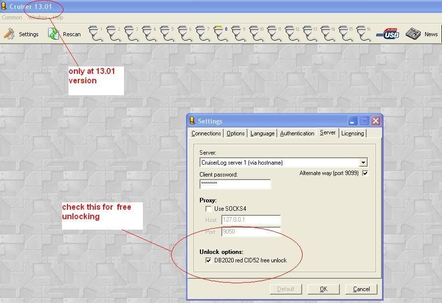

    unlocking db2020 cid52 is now free..using usb cable for cruiser
    yes... unlocking your db2020 cid 52... is now free...
    using your cruiser box...via usb cable...
    CID 52 patch unlocking
    1. For unlocking you can use only DCU-60 cable.
    2. Download latest firmware for your phone (ARM and FS file).
    Open USB cable window in Cruiser.
    3. In Primary tab -> Attach phone.
    4. Flash -> Write raw FS
    5. Security RSA -> Unlock RSA
    6. Flash -> Flash ARM
    7. Locks -> Direct unlock
    8. Flash -> Select language pack and firmware version matching FS flash file
    9. Customize FS
    10. Main tab -> Turn off phone
    CRUISER BOX Users:How To Upgrade CID 49,50,51 To CID52 :
    Be sure to upgrade the EROM before performing this conversion!
    · Attach the phone normally, then go to the GDFS tab,
    · from the Modify GDFS options list choose Upgrade to CID52 and press the Modify GDFS button.
    · Then turn the phone off (for example by pressing the Finalize GDFS button).
    The CID will be upgraded during the next EROM code execution, i.e. during phone startup or boot via DCU-60 (while holding the C key).

    This is quite useless for the average user. It's the unlocking procedure with Cruiser Plus (full version, you have to buy it) - patch unlocking.
    You can patch unlock DB2020 phones with the_laser's or den_po's tools already.

    first you must have this
    CRUISER PRO BOX
    download the latest firmware..13.01
    use usb cable..

    Cruiser Plus is not free. You need to buy it just like SE Tool 3. Even if you get the software from somewhere you can't use it because it's dongle-protected.
    As soon as the first unlock patches are released for DB2020 you can apply them with SE Tool lite 1.1 or jdflasher.
