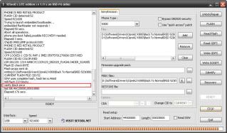

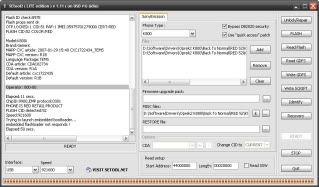

    Dear Brother...
    i've tried to use download this fw, i use this :
    K800_R8BF003_FS_C_ASIA_RED52.fbn
    K800_R8BF003_MAIN_GENERIC_WI_RED52.mbn
    HB1-06_Gen_CDA102568_7_R8A_GENERIC_C_ASIA
    but, when start to FLASH it, appear error mssg on setools like this..
    PHONE STATE: "RETAIL"
    FLASH CID: 0052
    Speed:921600
    OTP: LOCKED:1 CID:51 PAF:1 IMEI:35975701279000 CERT:RED
    FLASH CID:52 COLOR:RED
    PATCH:061205 1523 HANCXC9876543210_DB2020_MEM_PATCHER_R2A006 0
    LDR:061201 1314 HANCXC1329129_DB2020_FLASHLOADER_R2A005
    FLASH ID check:897E
    Flash props sent ok
    LDR:070904 1245 AN2CXC1250562_DB2020_CSLOADER_R3A013
    loader startup: executed
    loader GDFS startup: executed
    loader filesystem startup: executed
    loader unlock: executed
    BYPASS PACKAGE ABSENT FOR THAT FIRMWARE.
    "2007-01-29_07-01-29 15:40 CXC1722434_TEMS"
    Elapsed: 39 secs.
    and then operational was stopped..
    so i thought it wasn't success yet.
    and the K800i is totally OFF rite now..

    Why you try bypass phone without apply quick access patch before?
    Flash only Main again and apply quick access patch, then you can apply/remove other patches easy.

    Dear Brother,
    is use Setools software,
    sorry a dummy question,
    quick access patch > Is this one of support file that i need to insert when i flash the Hp again??
    or some option mark on Setool software setting menu?? coz i've look at the setting menu and missed to find quick access patch mark??
    Really sorry if my question looks like stupid one, but i'm really new comer to use this tools.
    this my Setools menu,
    Thanks for yur totally support bro'..
    Last edited by kaka.enine; 03-29-2010 at 07:51 PM. Reason: upload setools menu pic

    Dear Brother,
    here i sent error mssg when i try to flash it again..
    i use
    1st i flash it with mark 2 option "bypass DB2020 security" , and "use quick acces patch"
    and got this error mssg,
    2nd i flash it with unmark anything
    still confuse, what happen to this hp..
    or do something mistake to my flash step.
    please need yur suggest..
    And thank you very much..

    Top Team Gold senter's Avatar
    Join Date
    Nov 2007
    Device
    W705
    Posts
    1,958
    Thanks
    Thanked 344 Times in 283 Posts
    Re: [ASK] K800i Problem,
    Quote Originally Posted by kaka.enine View Post
    Dear Brother,
    i use
    You try to unlock phone ???
    Must make this:
