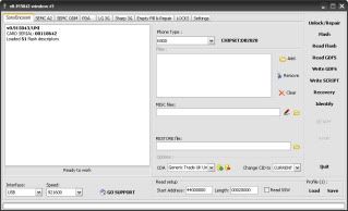

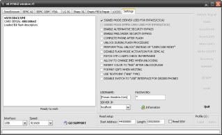

    Dear Brother,
    is use Setools software,
    sorry a dummy question,
    quick access patch > Is this one of support file that i need to insert when i flash the Hp again??
    or some option mark on Setool software setting menu?? coz i've look at the setting menu and missed to find quick access patch mark??
    Really sorry if my question looks like stupid one, but i'm really new comer to use this tools.
    this my Setools menu,
    Thanks for yur totally support bro'..
    Last edited by kaka.enine; 03-29-2010 at 07:51 PM. Reason: upload setools menu pic

    Use Setool2lite1.11:
