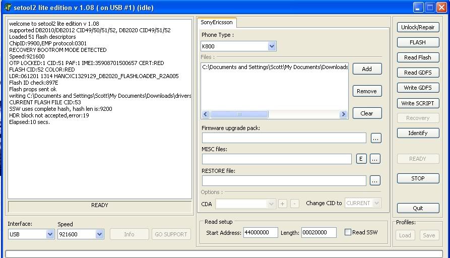

    Ok i was able to connect to XS++ by battery out/in, hold 2+5 then it found it... But ive got no idea how to use XS, so i tried SEtools cause i could see more options to click and choose. Yet i get these errors...

    Quote Originally Posted by vashcat View Post
    http://img.photobucket.com/albums/v6...red/SEhelp.jpg
    Click on Add button and use lastest Main: K800_R8BF003_Main_Generic.mbn then click Flash, disconnect USB cable, hold C ( or 2 and 5 together instead C ) and again connect USB cable.
    After flash on Main -> disconnect USB cable, reinsert battery and turn on phone.

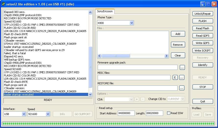

    Again sadly she doesnt want to connect to xs++
    Finally was able to get a flash onto the k800, tried repair, and gets stuck with an error from the gdfs?

    I had this problem with a k800(cid52) of mine. I had a backup of my GDFS though...
    I restored backup of GDFS after connecting to XS++ while holding 2+5, after this i had to unplug, take out battery, short the 2 battery pins on the phone (dunno why, maybe it doesnt do anything?),replace battery, plug it in again holding 2+5 then flash main and fs. Unplug, take battery out, put battery back in, plug in holding C and see if XS++ can connect, mine did.
    This is what i did and it worked (i had completely dead phone with the blinking ir when i tried to turn it on).
    Hope i helped.
    http://img.photobucket.com/albums/v6...oyred/halp.jpg
    Use Setool2lite 1.11 !!!
