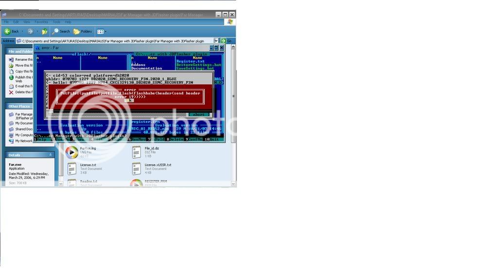

    I have SE W880i (CID 53 and i tried to flash it with far manager and when i push"yeah, flash it" i get this:[IMG][/IMG]
    how to fix this?:confused:

    I think you're trying to flash CID52 firmware into a CID53 phone. Search for the right firmware.

    Quote Originally Posted by wordas View Post
    I have SE W880i (CID 53 and i tried to flash it with far manager and when i push"yeah, flash it" i get this:...
    Use files for CID53:
    W880_R8BE001_MAIN_GENERIC_AI_RED53
    W880_R8BE001_FS_EUROPE_4_RED53
    HB1-06_Gen_CDA102568_13_R8A_GENERIC_EUROPE_4
