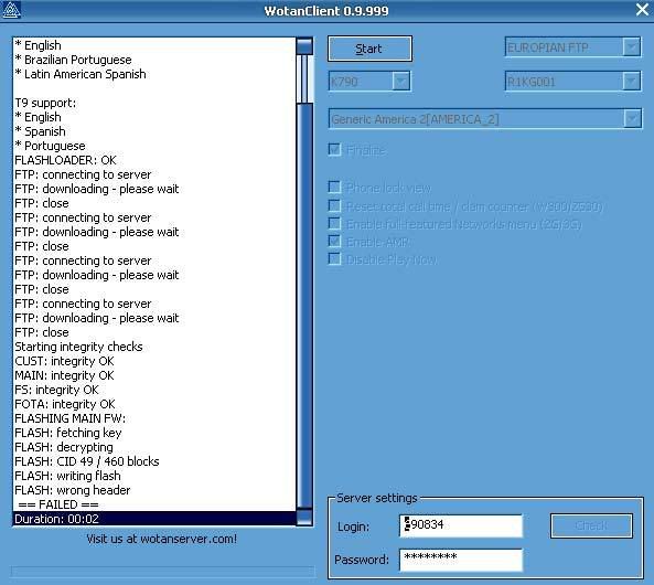

    I was recently upgrading my RED CID 51 K790a with the Wotan Client originally from CID 51 to CID 52 and that worked fine now I am tryin to upgrade to firmware R1KG001(General American 2) and I get a "FLASH: wrong header" error what could I have done wrong I had 2credits remaining with Wotan any suggestions? Should I try R1KC001 instead of the newest firmware? Did I pick the wrong CDA for my K790a?

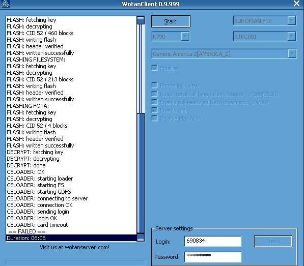

    I just flashed with R1KC001 and recieved a "CSLOADER: card timeout" what does that mean?
    I did the basics battery at 100%, no sim/m2 anything I had to do to do it right?

    The first error "FLASH: wrong header" is because the file downloaded is damaged. Try to download again.
    The second error: "CSLOADER: card timeout" is because the software can't start the loader to finalize the phone.
    The third error: "configuration error" is because the phone is not finalized.
    Download again the Wotan Client (save in another location) and download again all the firmwares and try again.
