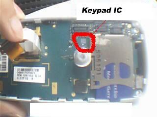

    I think it maybe hardware problem,you can change the keypad IC.
    Recently Initiate aerobomb's Avatar
    Join Date
    Dec 2006
    Device
    k750
    Posts
    Thanks
    0
    Thanked 1 Time in 1 Post
    Re: K750 Keypad not working
    i have the same problem with yours.. i replaced the damaged controller IC.. but perhaps you could try reheating using hot air... maybe it could help..
    hope you can fix your. it took 4months for me to find a replacement IC..
