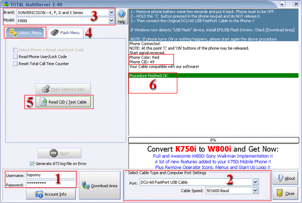

Read the CID / Test the cable
http://www.topsony.com/images/tms/fl...test_cable.gif
http://www.topsony.com/images/icons/1b.gif Fill username and password.
http://www.topsony.com/images/icons/2b.gif Select the cable type, port and velocity.
http://www.topsony.com/images/icons/3b.gif Select the brand of your phone.
http://www.topsony.com/images/icons/4b.gif Select "Unlock Menu".
http://www.topsony.com/images/icons/5b.gif Click in Read CID / Test Cable.
http://www.topsony.com/images/icons/6b.gif The program will read the Color information, CID and if the cable is compatible with the software. Remember the color and CID. You will use to download the correct firmware file. Wait for the message: "Procedure Finished OK".
