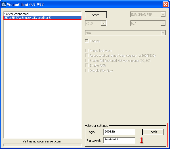

http://www.topsony.com/images/wotan/...otan_login.gif
http://www.topsony.com/images/icons/1b.gif Introduce user's name and password, and press Check. Observe the message in the information box, if his login is correct, will appear user OK, and the credit's number.

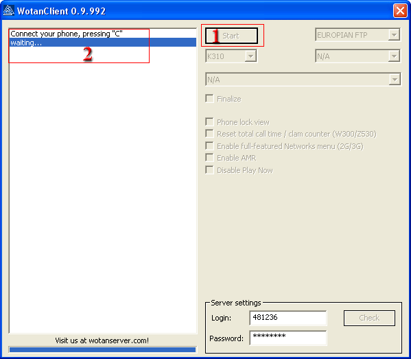

Turn off his phone, remove the battery, sim and memory card from your handset. Reinsert battery and do NOT power on the phone. Plug USB cable only in the computer.
http://www.topsony.com/images/icons/1b.gif Click the start button.
http://www.topsony.com/images/icons/2b.gif Press and maintain pressed the button C of the keyboard of the phone and connect the cable DCU 60 in the phone, you now can let loose the button C.

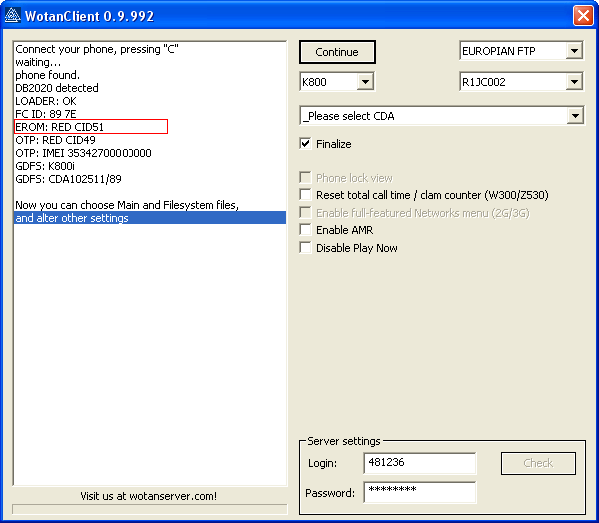

Once the phone is correctly connected you will see the data displayed as in the screenshot below.
http://www.topsony.com/images/gradie.../punt-nulo.gif
http://www.topsony.com/images/wotan/..._read_info.gif
You need to write down version EROM CID of your telephone. The certificate color must be RED. Example: RED CID 51, red is the certificate colour and 51 is the CID version. If your certificate is BROWN then we do NOT support it.

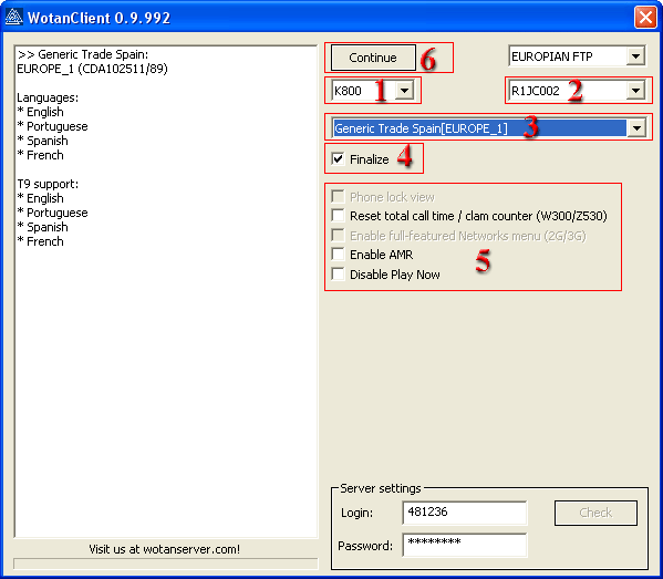

http://www.topsony.com/images/wotan/...ct_options.gif
http://www.topsony.com/images/icons/1b.gif Select the phone model.
http://www.topsony.com/images/icons/2b.gif Select the firmware version required.
Check the phone version CID with the firmware version CID that you want. The CID number is next to the firmware. Example: RA6B001 CID51. If your phones CID match's the firmware CID you will need 1 credit to upgrade your phone. If your phones CID is 49 and firmware is CID 51 you must buy 2 credits, 1 for CID update and 1 for flashing, The CID update is permanent and is only required once, in the future you will not need to do it again. If your phone is CID 51 and firmware is CID 49 then it is NOT possible you must use a CID 51 firmware only.
http://www.topsony.com/images/icons/3b.gif Select the firmware's language.If you want to Debrand your phone, click in "_Please select CDA" and look for in "Trade Generic" or "Generic" and see if any of them contains the language you want. If the latest firmware doesn't have your language, then check previous versions. Or if you want only updating your software with operator branded, click in the "_Please select CDA" and look for the firmware with your operator's name of network, and see if you find the one that is with the language that you want . If the the latest firmware doesn’t have your language, then check a previous version.
http://www.topsony.com/images/icons/4b.gif Mark the option "Finalize", without this option the phone doesn't work correctly, a message "error of configuration" will appear.
http://www.topsony.com/images/icons/5b.gif Select additional options - Verify first which options are supported by your phone. You find this information in www.wotanserver.com
http://www.topsony.com/images/icons/arrow-circ-neg.gifPhone Lock view - Reading of the user's security code restoring for default 0000.
http://www.topsony.com/images/icons/arrow-circ-neg.gifReset total call / clarn couter. - Reseting the total counter of calls. Clarn couter only w300 y z530
http://www.topsony.com/images/icons/arrow-circ-neg.gifEnable full-featured Networks menu (2G/3G)
http://www.topsony.com/images/icons/arrow-circ-neg.gifEnable AMR (Adaptive Multi-Rate) - Enable AMR voice codec
http://www.topsony.com/images/icons/arrow-circ-neg.gifDisable PlayNow - Replace PlayNow button with website link.
http://www.topsony.com/images/icons/6b.gif Click the "continue" button to start the procedure. Now the firmware files will be downloaded and flashed to your phone.
