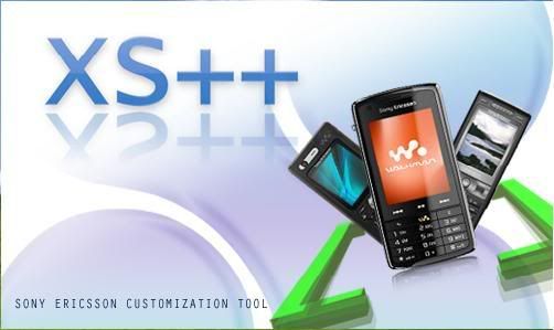

    1. Getting ready
    Download:
    XS++ 3.1 (Darwin)
    w800_r1bc002_main_eu_emea cid49
    w800_r1bc002_fs_emea2 cid49
    Extract and run XS++
    Plug your USB cable only in PC
    Turn off you phone and take out the SIM and Memory Stick.
    Make reset.
    Your phone is turned off during the flashing.
    Backup all contacts, messages etc. Flashing will delete them and all files in phone’s memory.
    2. Flashing Filesystem
    Click Start. You have 30 seconds to connect. Mark Flash File System. Open File System file (w800_r1bc002_fs_emea2 cid49). Click Flash. Follow the instructions and when program says Finsing flash click Stop. Ignore the error. Make disconnect then reset.
    3. Customizing File System
    Click Start. Connect. Now mark Customize File System. Choose Phone Model (W800) and CDA and Region (EMEA_2). Click Flash. Follow the instructions and Disconnect your phone when program says so. Make a reset.
    4. Flashing MAIN
    Click Start. Connect. Mark Flash Main. Open MAIN file
    (w800_r1bc002_main_eu_emea cid49). Click Flash. When program says Finishing Flash disconnect your phone. You’re finished! Insert SIM and Memory Stick and turn on your phone.
