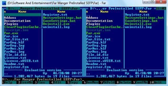

    1. Open FAR From The Pack.

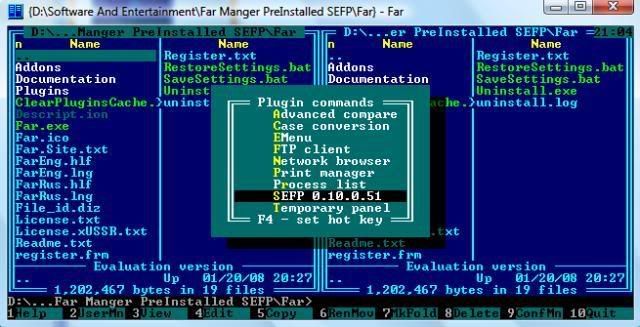

    2. Now Press F11 And Descend To SEFP 0.10.0.51 And Press Enter.

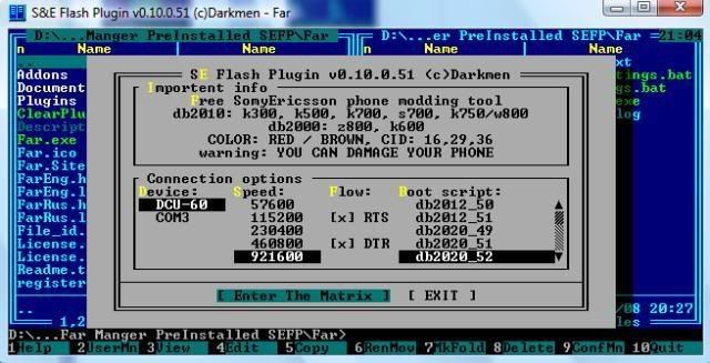

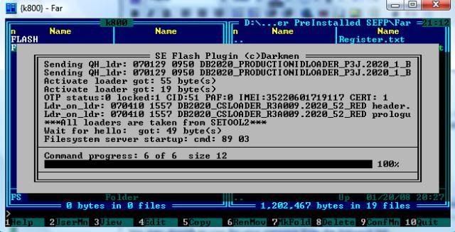

    3. Now Select DCU-60 As Cable Then 921600 As Speed And Choose You DBXXXX (In My Case DB2020) And Hit Enter The Matrix.

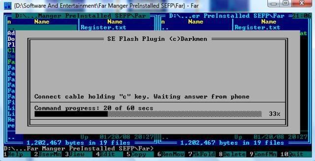

    4. Now It Will Ask You To Connect Your Phone. Take Out You Battery For 2-3 Seconds And Re-insert It. Now Hold 'c' Button And Connect The Cable.
    5. After A 2 Sec Screen, You Will See Following Folders.
    6. Now Click FS. And Wait For Loaders To Complete.

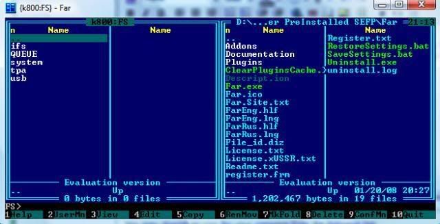

    7. Now You Will See Following Folders.

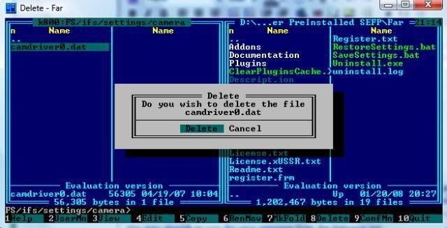

    8. Now Browse Around To Your Desired Folder And Delete The Content(s) Using F8. (See At The End Of The Thread Some Important Locations For Widely Used Files)

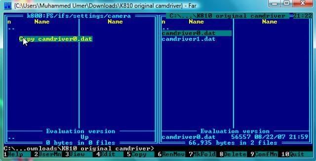

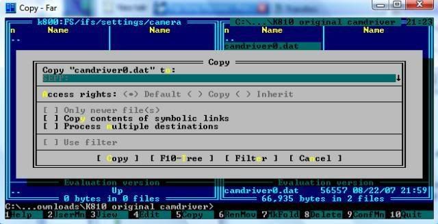

    9. Now Browse To Your Upload Folder (Where You Have The Uploading Files) And Drag Them To Left Pane.
    10. Now You'll See A Screen Like Following. Press Copy And You Files Will Be Copied.
    11. Be Carefull To Click Root Directory Until You Get CSFSLoader Shutdown Screen Like Following.
